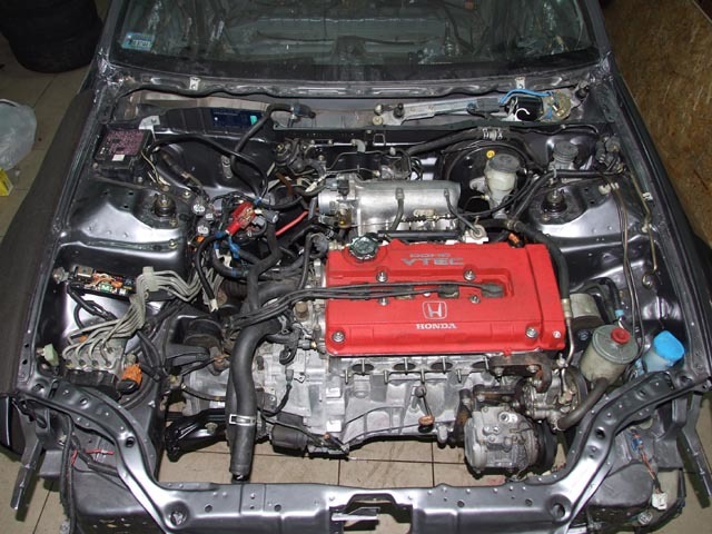

DONANTE:
http://img67.imageshack.us/img67/7725/resizeofzdjcie609copykh5.jpg
PACIENTE:
http://img431.imageshack.us/img431/5239/resizeofimg9692copydl0.jpg
the civic has been disengaged :lol:
http://img165.imageshack.us/img165/3984/resizeofimg9852copyjd8.jpg
http://img383.imageshack.us/img383/277/resizeofimg9885copydf8.jpg

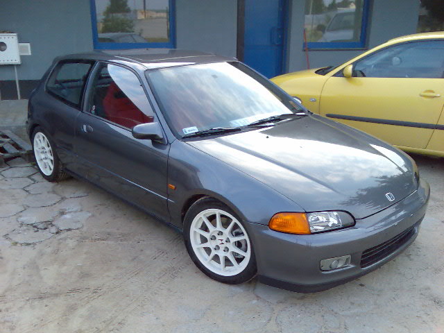

we sent it to be painted:
http://img218.imageshack.us/img218/9721/resizeofzdjcie694sj1.jpg

back from paintshop:
old (upper) vs. new colour (lower):
not much difference on the pic, but it is much colder and looks just great!

ready to take the new engine and suspension:
http://img440.imageshack.us/img440/4779/img2783copyyh4.jpg
ITR dashoboard removal:
http://img150.imageshack.us/img150/4742/img2820copyki1.jpg
reworked nut seats (to accept cone type forged nuts):
where’s the engine…?
http://img172.imageshack.us/img172/6107/img2933copy1qj.jpg
where’s… averything? :lol:
think it’s coming in here:
http://img172.imageshack.us/img172/7209/img2939copy8wn.jpg
http://img172.imageshack.us/img172/4051/img2940copy8ys.jpg

16" on:
http://img526.imageshack.us/img526/7567/img3771copyxe9.jpg

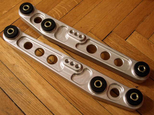

skunk2 adjustable upper control arms…
http://img161.imageshack.us/img161/4364/skunksyti3.jpg

all the poly bushings in place, asr reinforcement, itr swaybar, renewed calipers
brakes bled, skunk2 adjustable arms

finally will be able to work on front camber setting
and something for the rear
before:
http://img267.imageshack.us/img267/6346/stocklcasxh8.jpg
after:
http://img267.imageshack.us/img267/521/skunk2lcasmp4.jpg
stock vs. skunk2:
http://img267.imageshack.us/img267/1803/comparisonjz8.jpg
