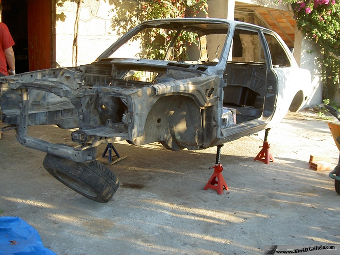

Comienza el destripado del coche
http://img710.imageshack.us/img710/4062/pict1032x.jpg
http://img94.imageshack.us/img94/545/pict1033.jpg
http://img832.imageshack.us/img832/3416/pict1034.jpg
hasta llegar a
